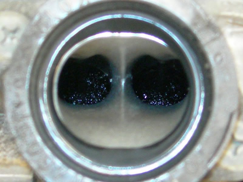

This is a picture of the intakes on a 600cc sport bike that was in for a full service -
All of the intake valves had that build up.
Tech said the valve seals were bad.
I'm not sure, they were all identical - the air filter was totally plugged, hummmmmmmm

DJ wrote:
What are we looking at through the hole, the top of the piston? Thats a lot of build up, whats next to clean it up? Is it an old 600 with years of build up?
It's a look down the intake port, at the valves.
It is a not that old Suzuki GSXR600 with around 20,000 miles on it.
We're not going to do anything to clean it up, but I have heard some claims from Techron and other fuel additives that they will remove those deposits.
They could be from running cheap gas.
