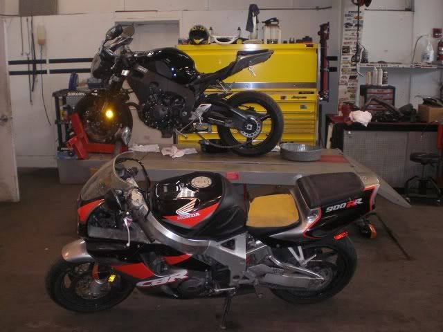

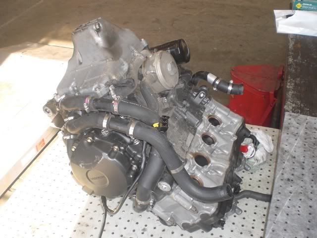

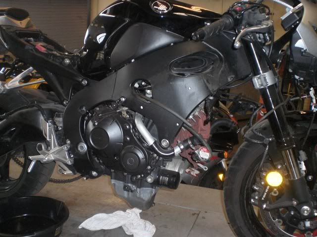

PostSubject: Re: CBR1000RR Crank Replacement   Wed Apr 06, 2011 6:40 pm
The technician was able to start work on pulling the engine.
Stripping it down -
In front, a 1993 CBR900RR one owner.
Engine out of the frame
The engine ready to be opened up tomorrow.

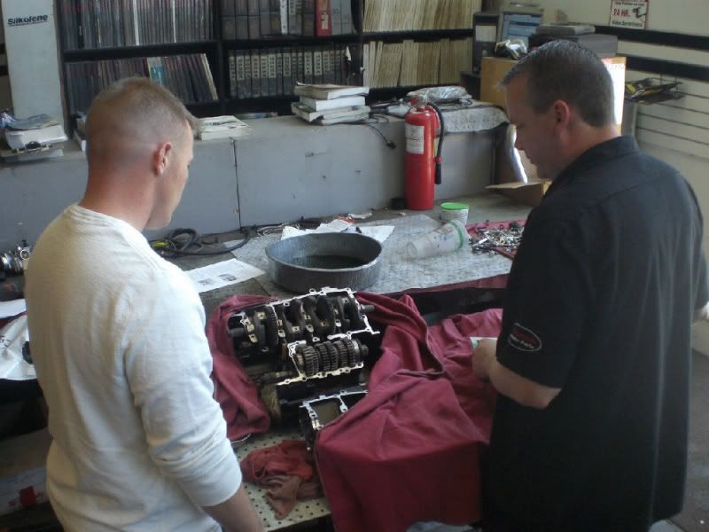

PostSubject: Re: CBR1000RR Crank Replacement   Sun Apr 17, 2011 6:21 am
The new bearings arrived.
A little plastigauge and we found a few outside of spec, additional bearings ordered.
Ben stopped in today and he wanted a look -
Thanks for coming over Ben, you are welcome any time!
