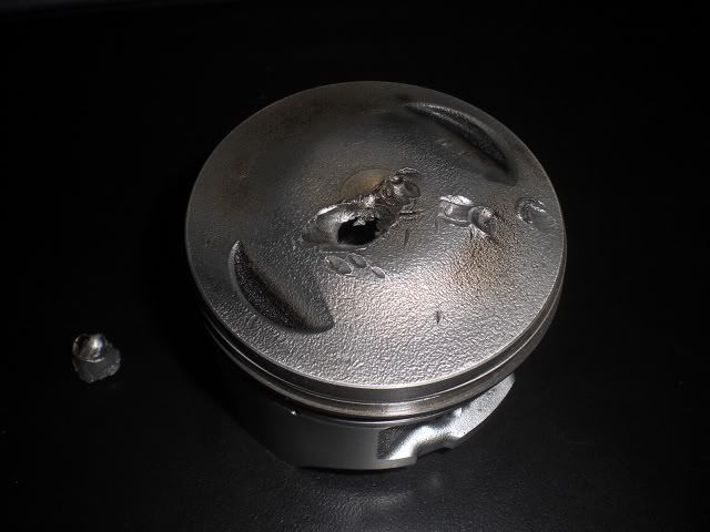

A Honda CRF150F came in, did not run, motor was locked up.
Here is the piston -
Dropped a valve, seemed to be due to a loose timing chain and previous owner mods (big bore kit).
